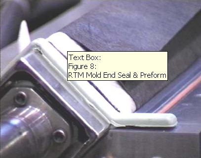

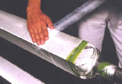

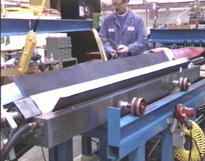

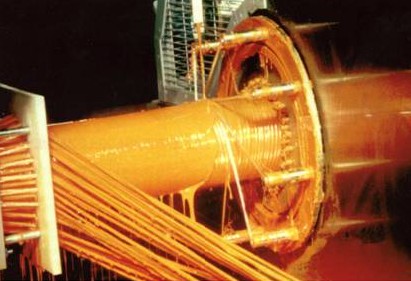

  第一回:缠绕怎么和RTM睡在了一起?

 楼主| 发表于 2009-3-31 11:11:26 | 显示全部楼层

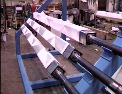

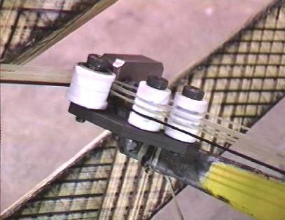

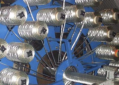

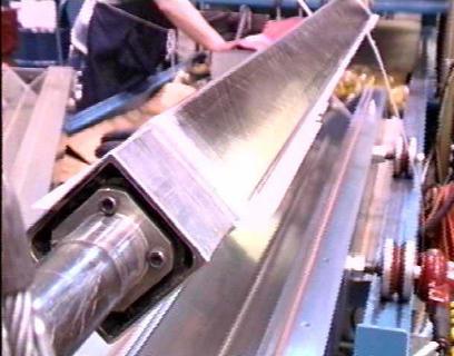

第二回:拉和挤从来就是一对儿,wound却成了可耻的第三者。
Reinforced-composite tubing and hollow profiles are produced by means of pull-winding, which reportedly minimizes wall thickness and weight while maintaining material stiffness and strength compared with conventional pultrusion technology. The process, which results in products that are 80% lighter than steel and 30% lighter than aluminium, is suited for the fabrication of medical devices where a high stiffness-to-weight ratio and nonmagnetic properties are desirable. A wide range of diameters and wall thicknesses and varied resins and reinforcement materials are available for applications such as resonance imaging tables, prostheses, and x-ray fixtures.
发表于 2009-4-1 13:36:50 | 显示全部楼层
谢楼主分享,这东西刚出来的时候着实把我吓了一跳,当时都没听过pull-winding这词儿,这么多年了也不知道国内做的咋样儿,没了解过。

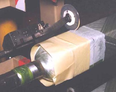

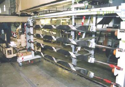

 楼主| 发表于 2009-4-2 11:10:53 | 显示全部楼层
续第二回:第三者转了正了---“缠拉挤”才是下面图片的意思。不过有一张图用来生产玻璃纤维增强热塑性塑料管很不错的。
