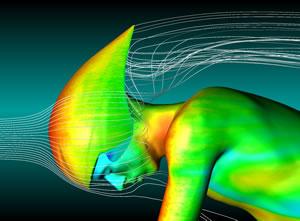

The STEP file containing each helmet design and the human geometry was imported into Fluent’s Gambit software, where it was meshed for CFD analysis and a flow domain was generated around each model. The meshes ranged from two to seven million cells, depending on the geometry that was modeled. Wherever possible, prism cells were generated over the surface geometry to capture boundary-layer flow features in detail.
Fluent software was used for CFD analysis, which incorporated data on boundary and physical conditions that SERG had acquired from a previous British Cycling project.

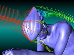

CFD results were imported into CEI’s EnSight software, which produced highly detailed flow visualizations showing the aerodynamic properties of the helmets. SERG chose to concentrate on the drag and lift forces in the simulations, using isosurfaces to show wake structures and particle streamlines to visualize swirling, recirculating flow paths.
Based on the wake structures and recirculating flows in the visualizations, SERG was able to quickly identify how different geometric components of the models – such as the helmet and cyclist – interacted and influenced each other. They were also able to pinpoint large wakes that resulted in high drag forces.
Hart colored different aspects of the model within EnSight, and applied properties such as reflective surfaces for the bike and helmet and matte surfaces for fabric and skin. Lighting effects applied to the model helped complete the life-like look, according to Hart, making the results more believable.
“The flow visualizations and images were vital in presenting the physics-based simulation results in an understandable manner to the cycling team,” Hart says. “Being able to clearly show a client what is happening is essential to their understanding of the results.”
Hart and his colleagues used the EnSight images and animations to reinforce the hard data output from the Fluent simulations and help the engineers understand the flow physics that created the lift and drag forces. Based on the results, SERG was able to recommend an optimal helmet style that reduced aerodynamic drag and lift.
“The quality of the model geometry from Geomagic Studio and realistic color renderings and surfaces we applied in EnSight enabled us to incorporate a great deal of realism in the visualization,” says Hart.
