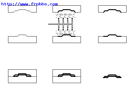

 楼主| 发表于 2007-5-11 18:38:34 | 显示全部楼层
多个喷头对复杂模具、上下模具的同时涂敷
- typical applications include,
- autobody panels
- sanitary fixtures
- sports equipment
- bathroom fixtures
- machine and electrical housings
- multiple molds can be coated at once
- robotic coaters are available
- limitations,
- plastics can be hard to direct into the mold
- parting lines of the mold build up extra material
- the powder between the mold halves must be removed after the mold halves are brought together.
 楼主| 发表于 2007-5-11 18:44:26 | 显示全部楼层
对复杂模具、上下模具的多喷头同时喷涂
见附件图片。希望能上传。
